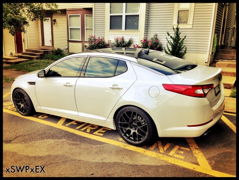

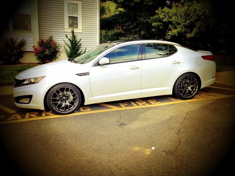

XSWPxEX setup:
Avant Garde M310 Dolphin gray
19x8.5 +35 Front and Rear
245/35/19
Megan springs
No rubbing at all so far.

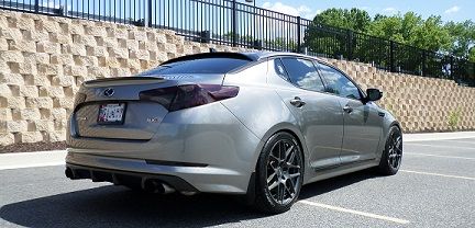

Suspension: Eibach Pro Springs (revised)
Rubbing: Slight inside driver front when fully locked to the left. Happened before being dropped though.
Ride Quality: Close to stock SX on all but harshest bumps. Rides very good IMO. Handles corners fantastic now with virtually no body roll. Will update after they settle if this changes.
-ASH

My old setup
22x8.5- 40 offset with 245/30/22 tires. (235 would better)
NO RUB, Full turn lock to lock
Ride quality- like stock
If your going to drop it with 22's it's coilovers or nothing....springs will give a rub. (99% positive)
My car on coils.
