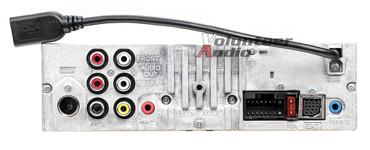

I own a 2013 Optima, it's got non-UVO. I recently bought and had this aftermarket head unit installed: Sony XAV-AX100. Here is what the back of the head unit looks like (from the back it looks like a single din, but from the front it is a double din). And here is the detailed schematic from the manual (scroll down to page 24 or download PDF).

- Second, if my guess is correct, then all I need is the Axxess AX-HYKIAUSB adaptor and then plug the end with all the pins into the back of the multimedia module, and the USB end into my head unit's USB cable. And I -THINK- the AUX end would go into the front or rear plugs shown on the left side of the back of the head unit. BUT This means I would only get front or rear speakers playing from AUX, right?
Correct you will need the Axxess Axxess AX-HYKIAUSB. BUT the only thing you will be able to retain is the USB, because that Sony stereo doesn't have any AUX inputs. The Rear RCA's are for amplifiers and 1 for backup camera.
