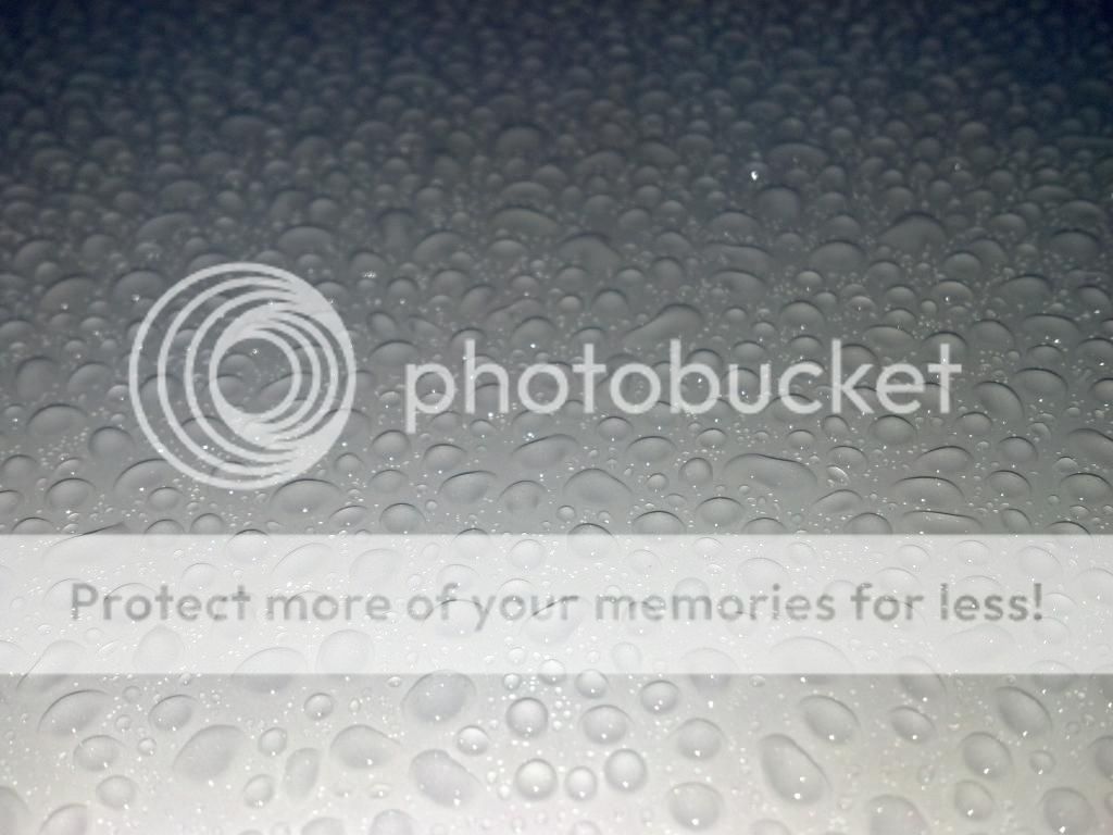

I met a guy, one of my nephew's car club buddies, who runs a place called Diamond Detail here in Bel Air, MD. The moment he saw my car, my nephew says, "my buddy wants you to bring the car up and he wants to detail it for you".
So I brought the car up one evening while there were all getting ready for H2O (Big meet in Ocean City, MD @ the beach annually).
He went to town on my Sonata. From bug/tar removal, washing, clay padded it, washed it, then compounded a few spots, then polished the entire car. While the polish set up, he proceeded to do my entire engine bay and polished my upper strut bar all by hand.
When he was done, I could see the deep deep pearl that I fell in love with when I first bought my car and did the initial detail myself.
Here was the rain three days later:

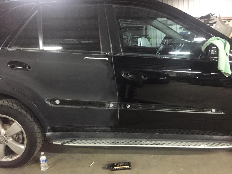

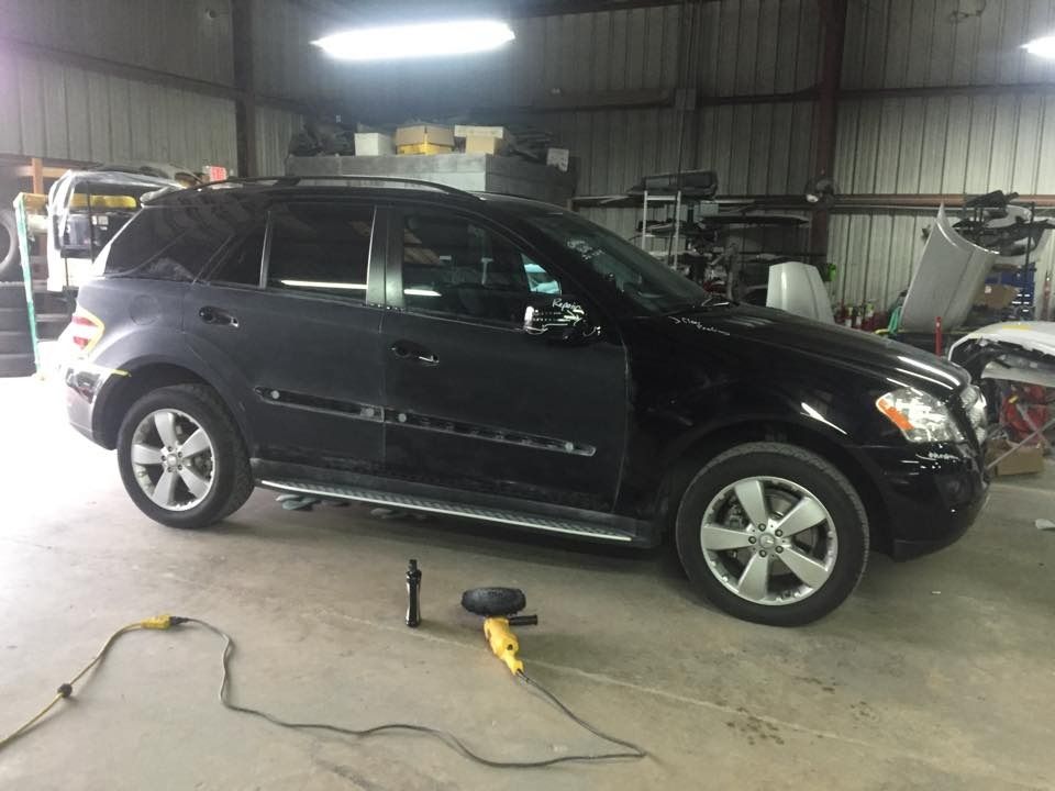

I work in a body shop and im the detail guy over there. here's the easiest process in detailing cars.
1) Wash your car.
2) Wet Sand The Whole Car by hand. (you can skip this if you dont have any dirts that cannot be wipe off on the car)
3) Rubbing Compound + Cloth Pad (using a machine polisher).
4) Machine Polish + Foam Pad (using a machine polisher).
** Using a machine polisher makes a big difference, you need to adjust the speed too, if you go too fast you burn the paint)
NOTE:
- i/we only use DA if the car has a really bad paint job.
- DA will also give dent to your car if you dont know how to use them, even some people doing them for yrs still dents the car, base on my experience but i havent dent any cars yet. (knock on wood!) :lol:
Will post some pics later.. Son turned 4 today so gonna be a busy day..
