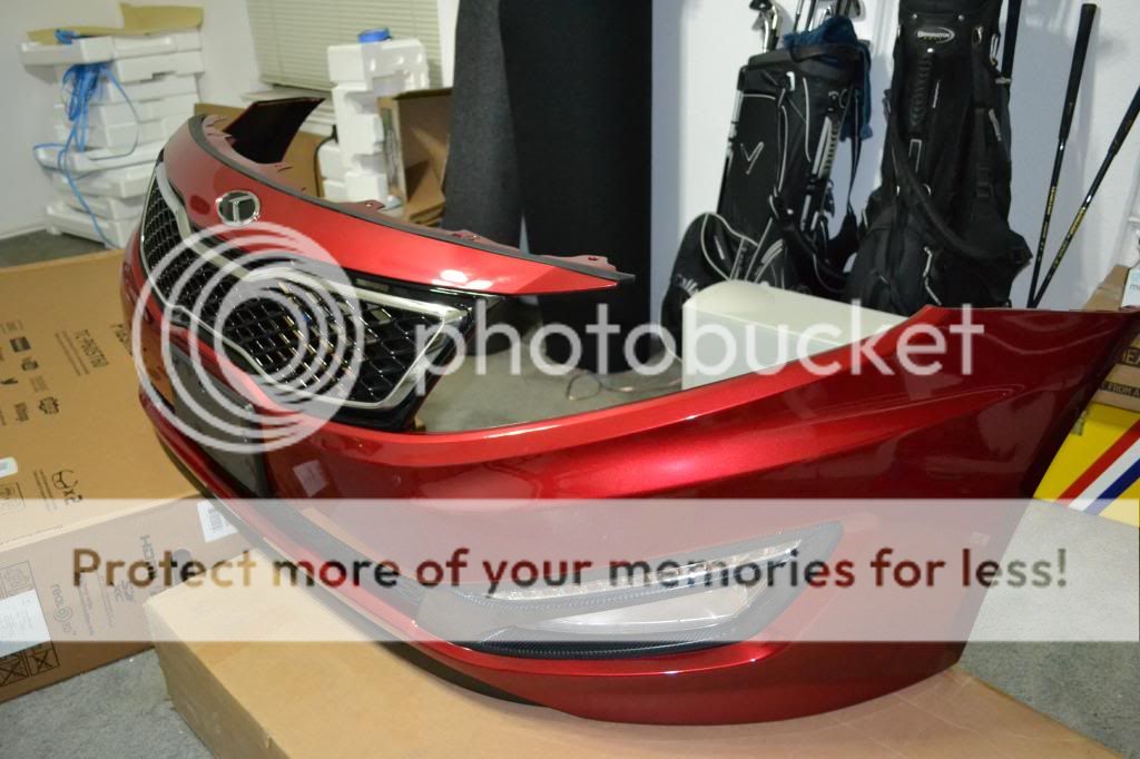

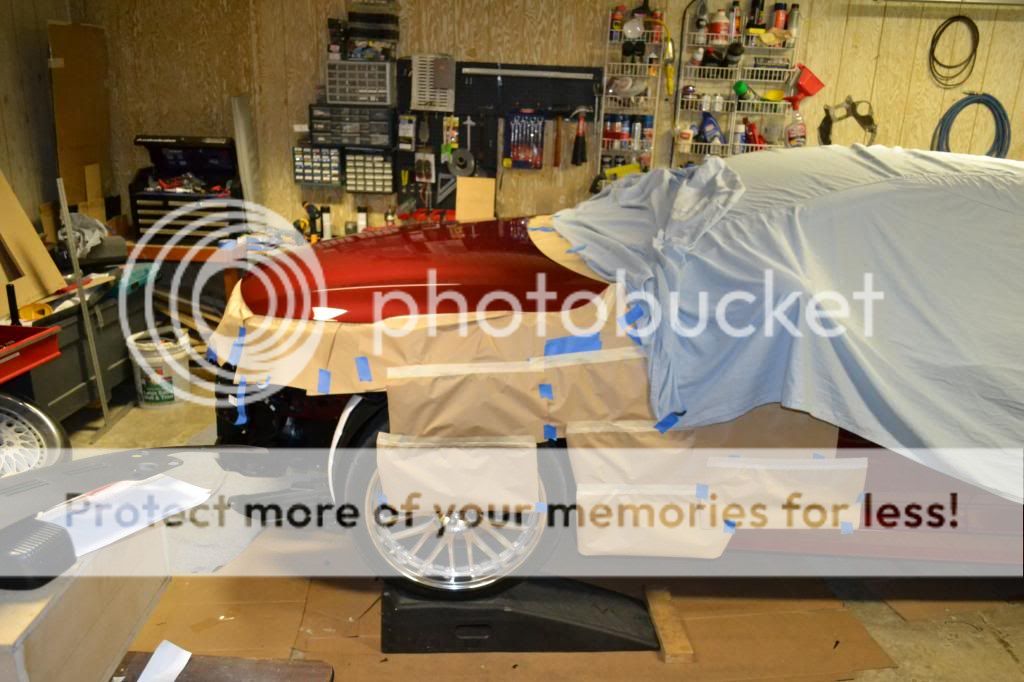

First step is the same as if you were going to be painting a car. Prep and taping. This takes forever to do if you do it right. I think it took me somewhere around 3 hours total. Here is what our car, now only 2 days after picking it up looked like. I removed the front bumper, and COMPLETELY disassembled it in order to get a complete coating of the 3M Paint Defender.
Once you have everything taped off... it's time to wax the areas you intend to spray with the film. 3M provides a wax in the kit but I went before it with a Poor Boys light abrasion buffing compound first in order to remove any swirl marks that were in the paint. Waxing is pretty self explanatory, just make sure you have complete coverage because it really makes a difference as to how easy this comes off.

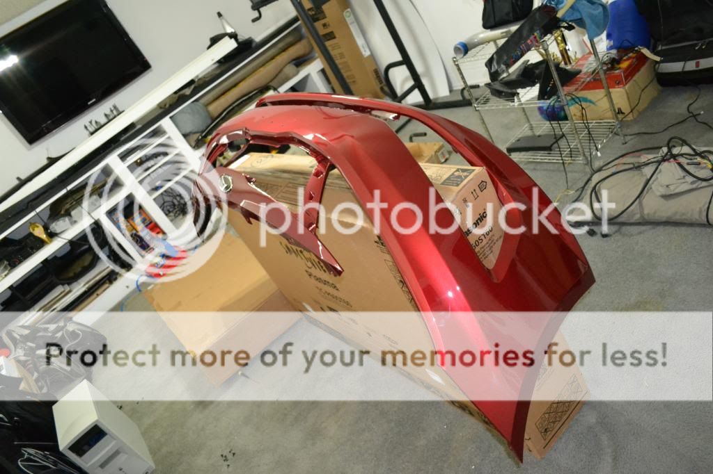

The above shows the bumper after polishing and waxing but BEFORE the 3M Paint Defender was sprayed on.

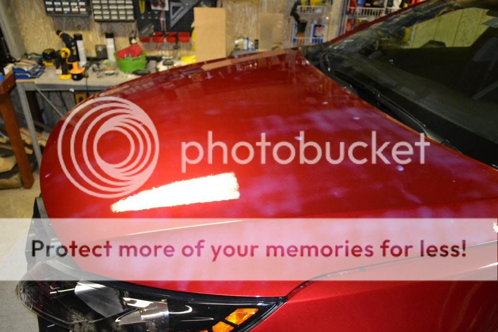

Here is what the hood looks like after spraying. The milky finish is, apparently, how it is supposed to look immediately after spraying and for quite awhile (at least a couple hours) while drying. It dries to the touch in 4 hours and fully cures in 4 days. This is EXTREMELY important. It must have a full 4 days to cure without ANY moisture getting on it.

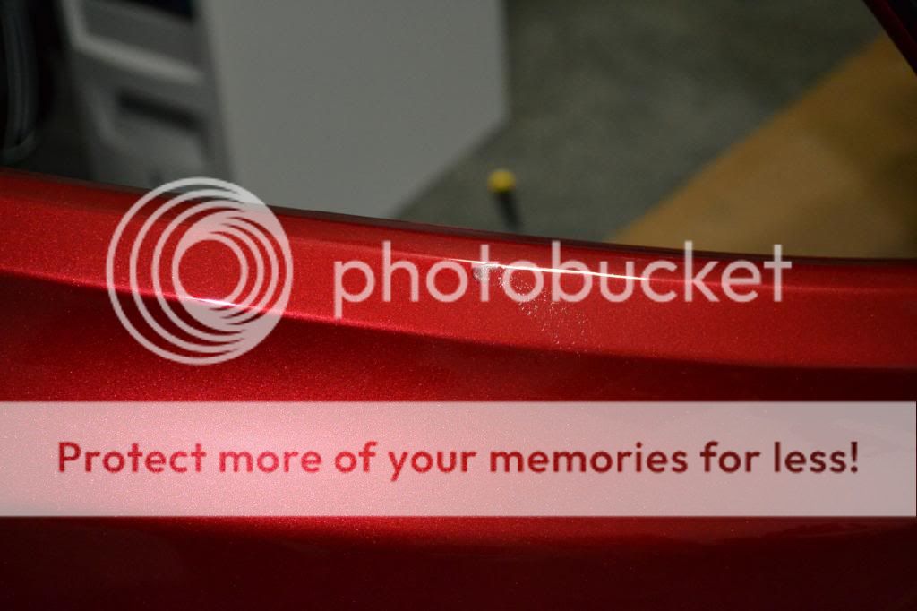

The above pictures are post spray after about a day of dry/cure time. Over all it looks great. There is a definitely noticeable orange peel to the finish when looked at closely though. My main complaint (and suggestion) is that you MUST buy the spray gun attachment for the cans. If you do not you will end up with blemishes like I had pictured above. What happens is the stuff clumps because it is THICK... really thick. It will clump on the spray tip and then fall onto your work area creating a "bubble" or blemished area even after cured.

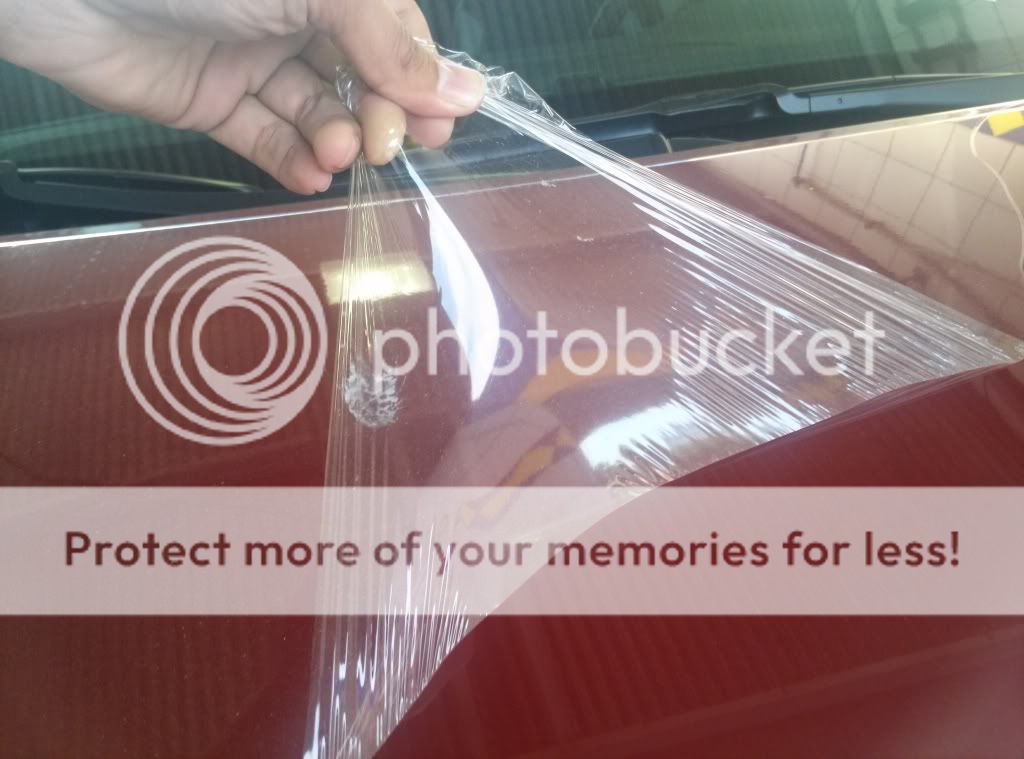

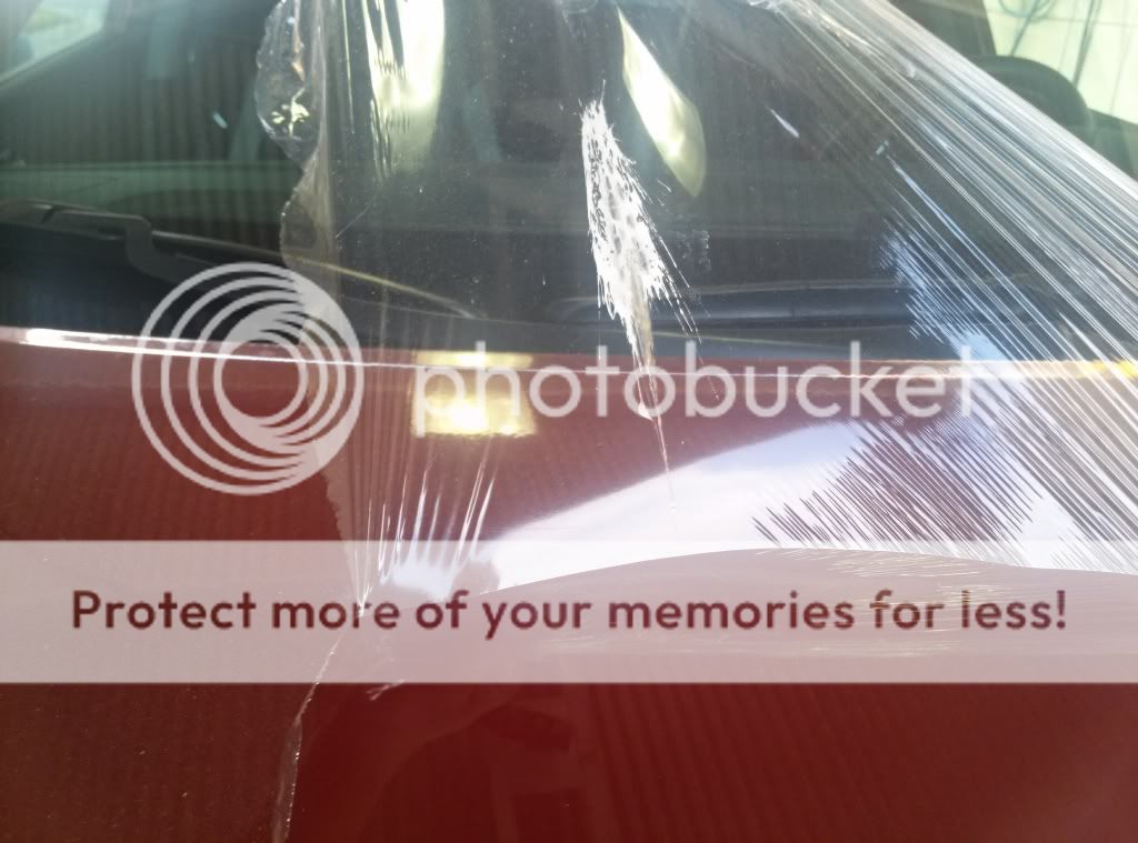

The above shows the removal on the hood. I did not take pictures of the bumper removal because my soul was dying with every passing hour. You can see the protective qualities. It is actually a pretty strong film once fully cured. Look as I peel off the bird poop and dirty film before washing the car.
