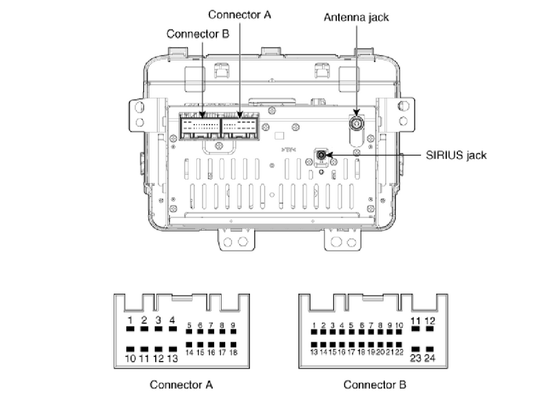

No aftermarket headunit will retain the existing mic. But there is a slight work around to getting it to work. You have to cut the microphone jack and splice it into the main harness. What stereo did your car come with? I might be able to help you out.

Just the basic head unit.
On connector B splice into Pin 10 & 22. Very simple to do.
Pin 10 is Mic +
Pin 22 is Mic Ground
