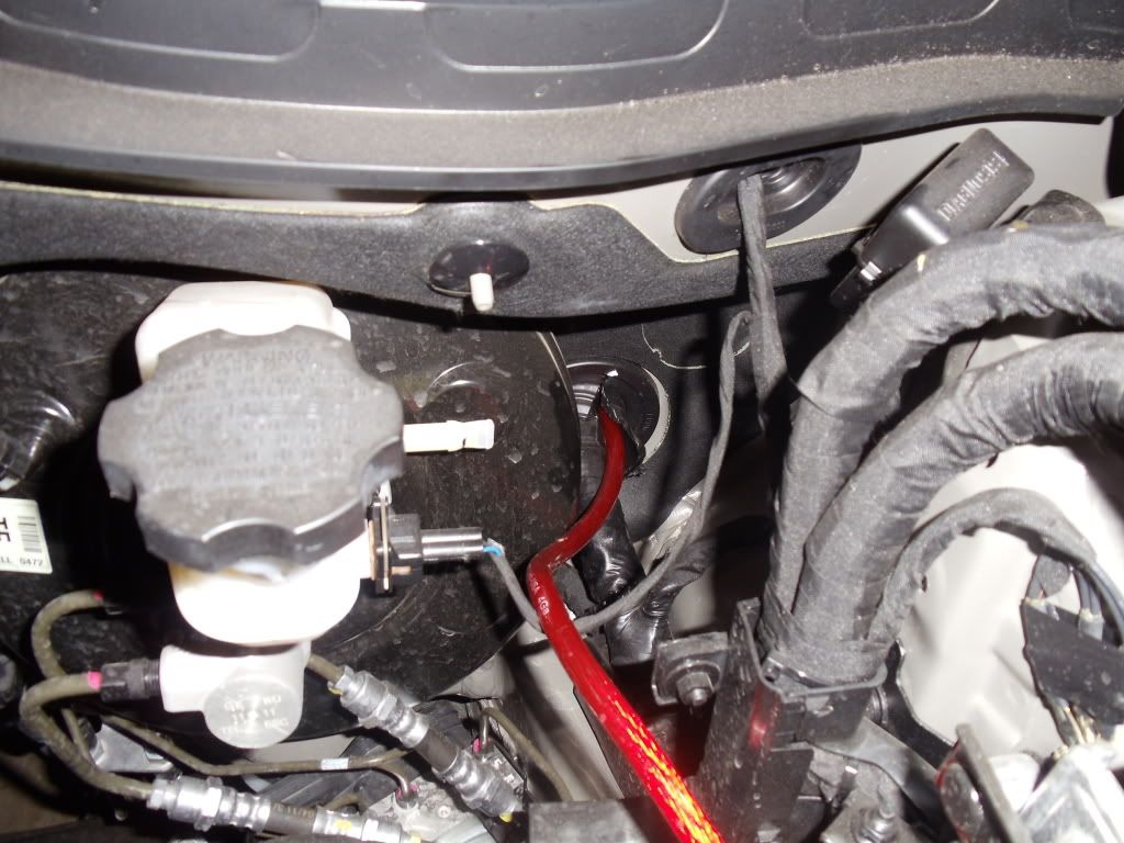

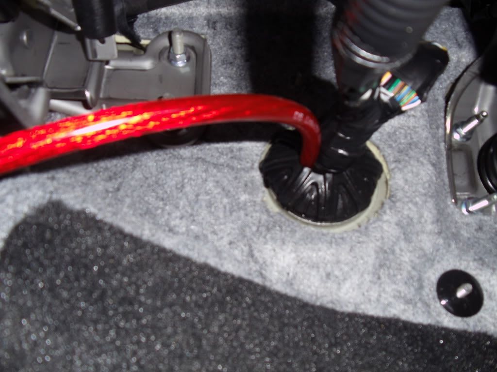

sorry if this has been posted or not, but when i installed my audio (adding subs and amps) i made a thorough research but cant find any, i spent at least 2 hours doing research while my project still on halt...i was having trouble looking for "remote signal" to activate the amp..some says cigarette lighter may do the job, yes it is but u need to pull wires to the front...
here is how i do it, power cable pulled from the battery through the firewall..

NOW...as for the remote signal...
Connector A, pin 7, tap a wire into it and connect it to your aftermarket amp "remote" terminal..it should switch on and off the amp, following the "acc" from the key or double clicking the start push button..
i tested and it worked perfectly..
i asked car audio technicians, they said its not possible to take remote signal from OEM amplifier.. but i made it possible.
sorry for the lack of pictures, because im at work lol.
