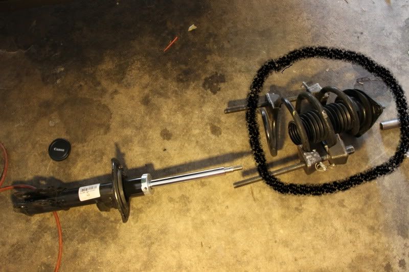

Thanks for the write up. I did my 4 Eibach springs in just under two hours with hand tools. The only thing I would add, is you can release the energy in the front springs by taking the strut nut off lastly, then lowering the jack. Everything will slowly fall apart well.

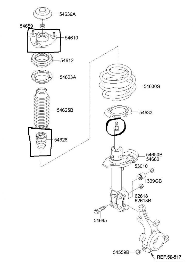

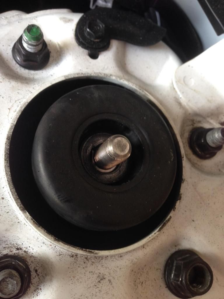

Anyone know how to get the strut tower off the strut? Yes, the middle nut is off completely. i took whole strut out and could not pull it apart. Then i placed the 3 bolts back that hold the strut tower to the car body frame under hood and tried pulling downwards, didnt work. then i hit the actual bolt with a hammer and still stuck?

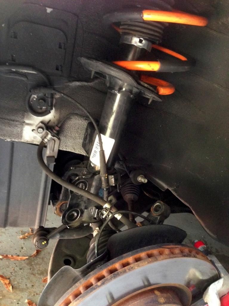

I have no pressure because im taking off Megan springs. i think the stock springs came off easier due to pressure pushing outwards. you can see how loose the spring is in the pic
any help appreciated

I took the whole strut, spring, strut tower, everything out. Yes, after I removed those 3 nuts you circled. Then......My problem is, I cant remove the spring because the strut tower is stuck. Let me circle the piece that does not come apart.
It is stuck on the shaft

Ok, maybe this clarifies thing little more.
The bolt pictured with a circle around it(even with the nut off 54659) will not release itself either from 54610 or 54626 (parts labeled with squares).

As was said above, you can remove the center nut before removing the strut so when you lower the strut assembly the spring doesn't go flying. It doesn't do it if you remove it on the floor either, it goes about 1ft. You risk stripping the last thread on the nut if you let it do that though so save yourself some headache and take it off before lowering down the strut. Spring compressors are absolutely not required if you do it this way!
