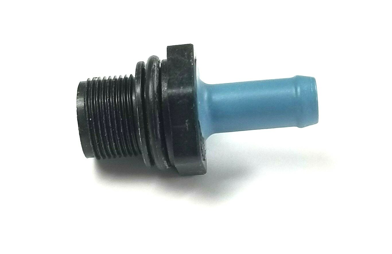

Do you remember if your old PCV valve was blue colored? I've seen blue or black replacements for my 2012 2.0T engine, but my understanding is the proper replacement is blue not black.
I don't know the differences between the blue or black PCV valves. I think they will physically fit the same port, but maybe there is a difference in flow rate or pressure to open/close the valve?
It's a hassle now that you have the black PCV valve, but if you originally had a blue OEM PCV valve, it wouldn't be too much additional cost to just get another blue one and replace your black one?
I think the blue PCV valve has a different OEM Kia part number compared to the black PCV valve.
EDIT: here is an example of a blue PCV valve: 2011-2016 Kia Optima 2.0L 2.4L PCV Valve 26740-2G600 Kia OEM | eBay

Hey King; I normally keep everything and can't believe that I threw the old one out. I don't recall the color of the old one but can't believe that it would operate so differently even if it wasn't the exact same PCV valve and would have led to the valve cover leak?

Hi King, I have a 2014 Optima 2.0T and my PCV valve was blue. Not sure if the 2012 was the same, but wanted to at least confirm what mine was. Hopefully that helps.

Test the one you put in, should rattle if shaken.
I did check the new "black" PCV valve before installing and confirmed that it did indeed rattle. Wasn't sure how to test the old one to confirm that it was working correctly before replacing with the new "black" one but it also rattled so not sure on that.
