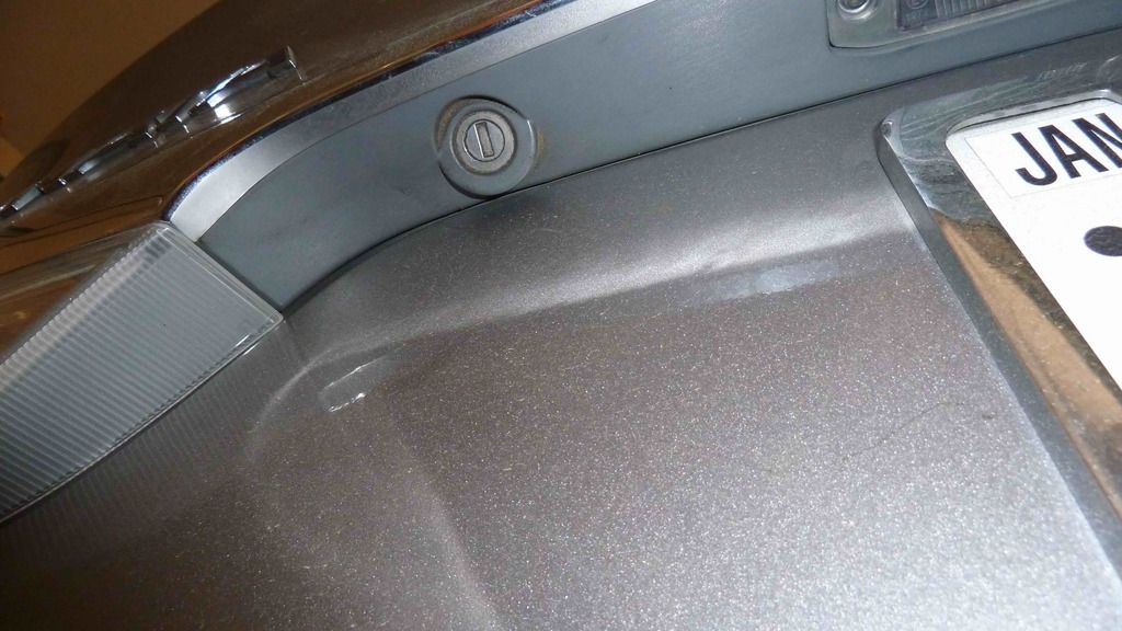

Also when my battery died i cant open the trunk! tried to pull the string cable just beside the headrest on the back seat but didnt work so i grab a long stick and reached that green tab inside the trunk... what a pain in the Butt..
