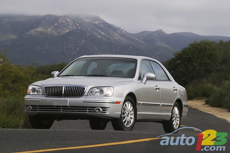

Not trying to threadjack, but it looks as if the XG 350 was a very early attempt at trying to move in on Mercedes Benz. I never knew this car even existed:
See less See more
I wasn't aware of this vehicle either before I read the thread on the other forum. Not the best looking car I have seen !....but great that the brake calipers are direct fit with our cars...(I'm hoping )
