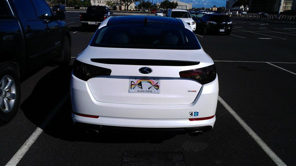

Hello everybody, welcome to my showroom/ Projector build thread
Please see posts #2,3 for my projectors,
Here is Alfred (wife named it , short for Alfredo)
(note i am bad with photos, so please don't mind)
All photos taken with my phone

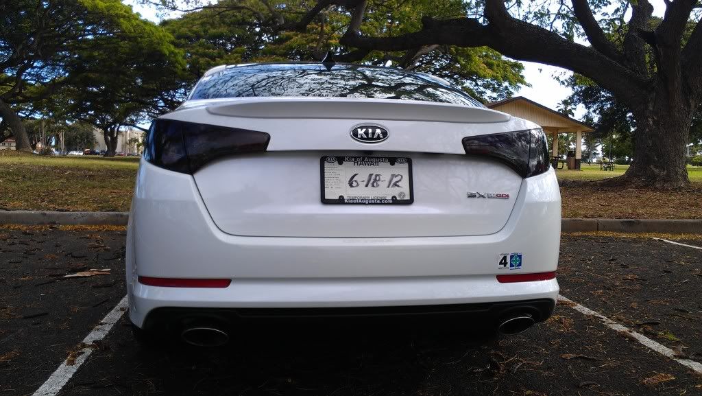

First mod, 60% VLT taillight tint, all LED interior lights, blue dome light leds

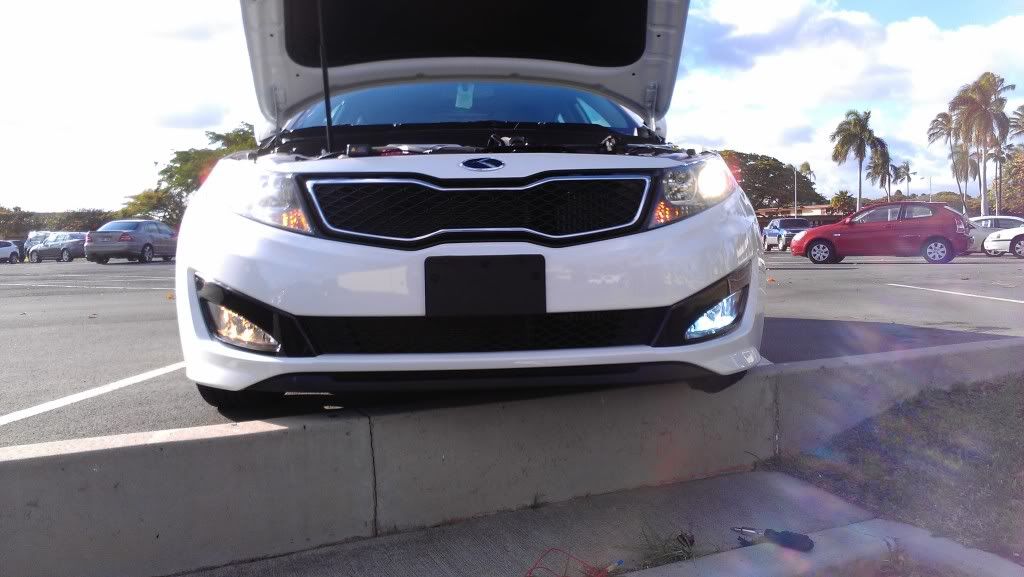

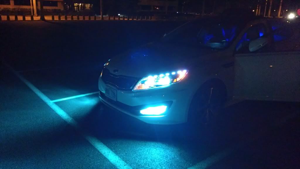

Then comes 3.0 K badges and HID fog lights (H11B bulb)
8000K D1S bulbs to match my 8000k fogs
Experimental LED lighting :

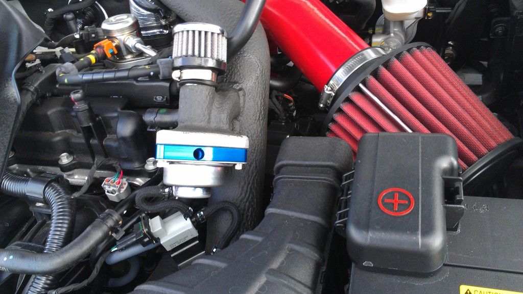

SRT4 Blow off plate & Fabworx Short Ram Intake

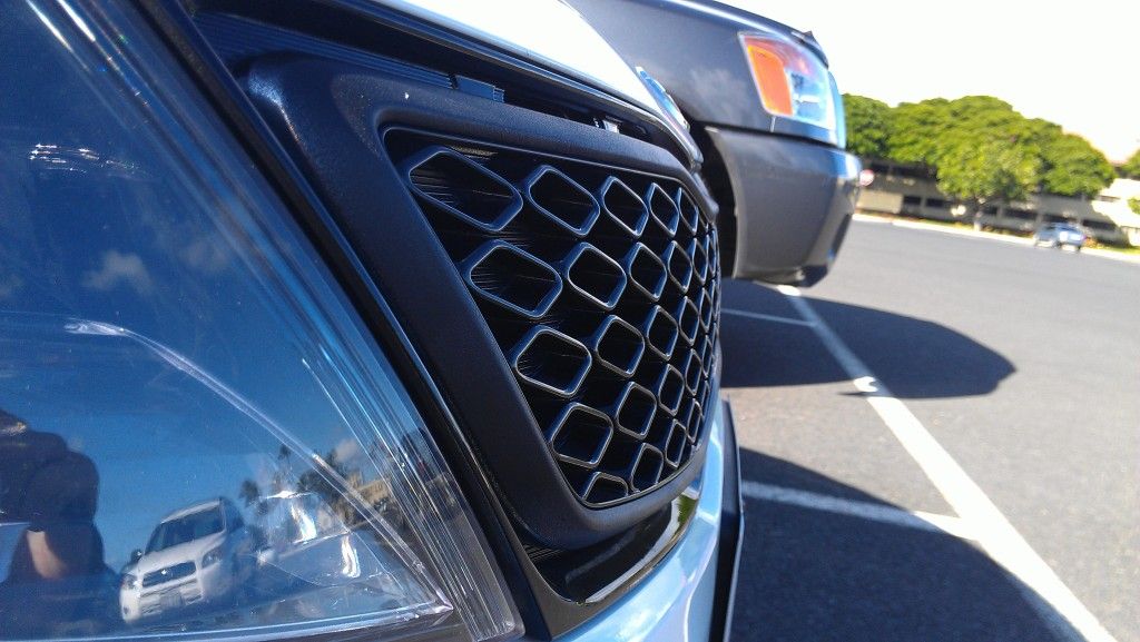

Plastidipped black grille and trunk lip

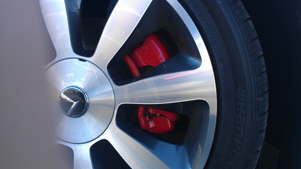

Duplicolor red calipers

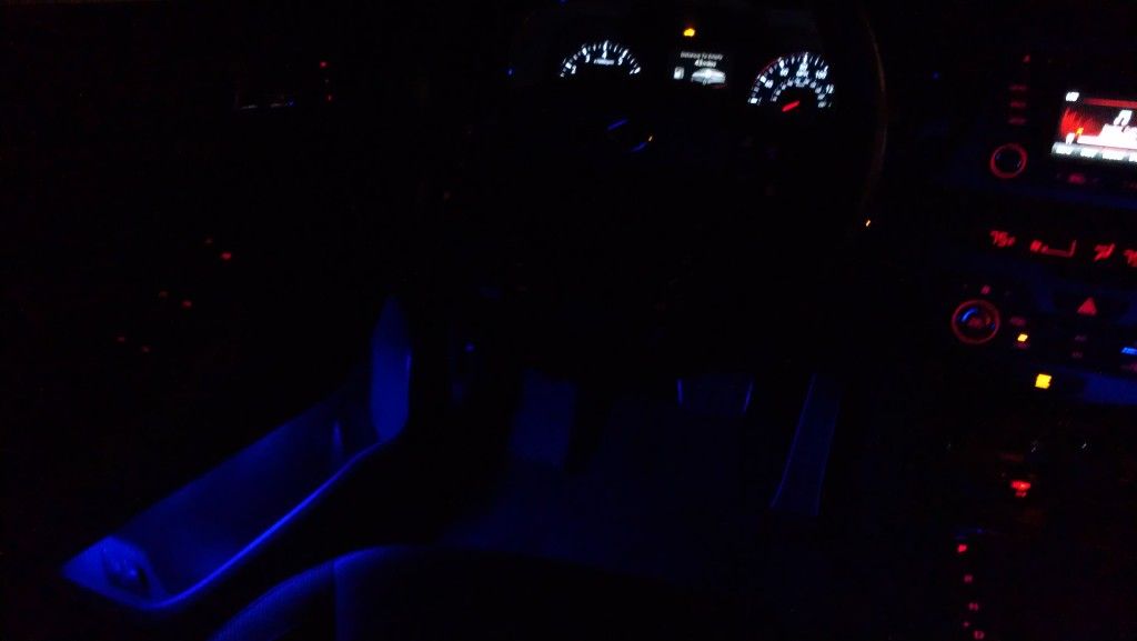

Door LED mod

Door welcome light mod
http://www.optimaforums.com/forum/7-optima-appearance-body-modifications/12904-different-kinda-puddle-lights.html

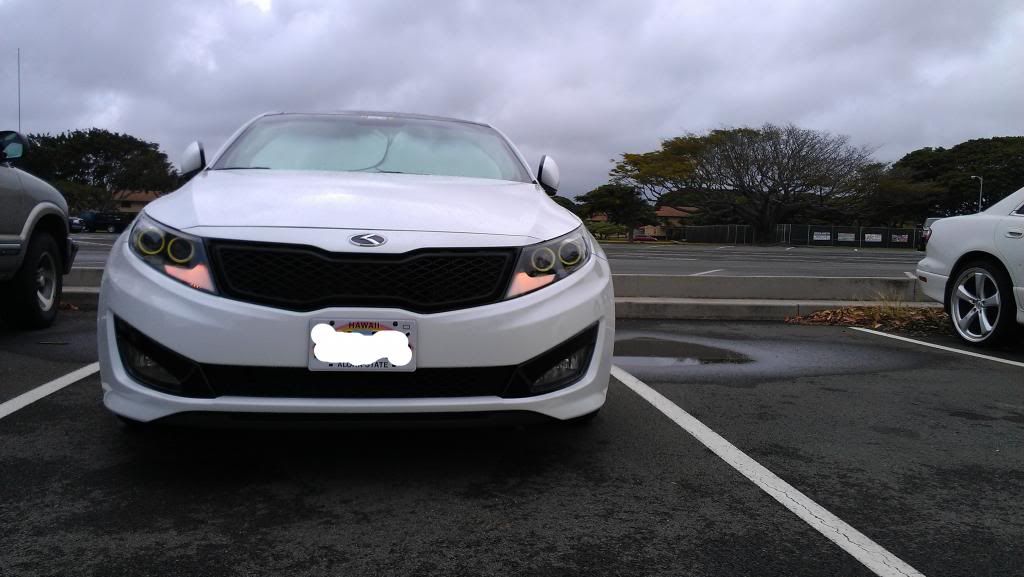

Stock HID projectors with STI-R clear lens swap
BEFORE:
AFTER:
Quad Halos

Thanks, almost done on my test unit, just waiting for some white vinyl and a hid kit to come in the mail
Looks great!!! Did you separate your headlights yourself? If so have you done it before? If not, how hard would you say it was? Sorry for all the questions.
Yes i opened it myself. have zero experience doing it before.
It was fiarly hard as i cant fit the headlight into my oven so i had to buy a electric heat-gun from lowes
Takes quite a long time going around the unit trying to heat up the glue and prying, and since this was a test unit it got scratched up quite a bit as i wasnt taking care of it.
I was also rushing as i was excited so i think it would have been easier if i took more time heating up the glue.
Took me a couple hours a 3rd degree burn and a couple blisters before getting it open

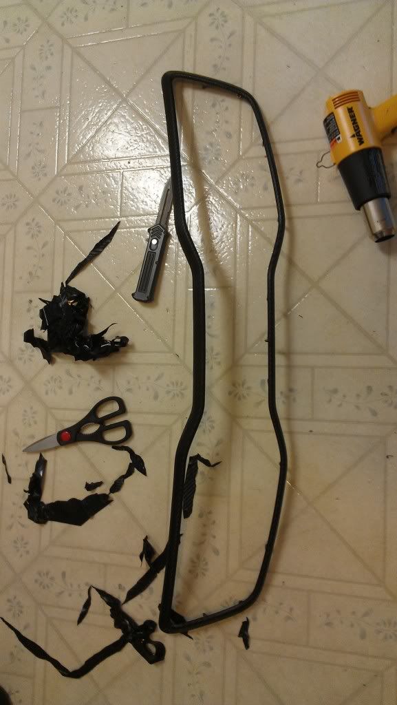

awesome headlights.. Hey how did u just take the chrome off the grill? Think i need to do that in order to carbon mine..
After you take the grill off, there is a bunch of screws in the back. Just remove those then pop the chrome out of the 4 tabs and its out

Discussion Starter #13 (Edited)
you should make a DIY for angel eyes and headlight modification thread. Thats some nice work!!
Idk about a DIY. Most people are reluctant to open their headlights
I will take more photos of the steps I go through when I do the passenger side.
At the moment I don't have the angel eye or the second projector running till I can get the other side done . I got it wired up so all 4 projectors come on together. And the high beam signal activates the bi-xenon solenoid

But it would be a good reference for those who may and wanted that information. I would actually like to do this but only if I can find a spare headlight set. I just don't have time to take my headlights off and do a project that would take some time to complete. I do like the halo thing though.
I was originally planning to take off both stock headlights and get the project done in a weekend. But then i looked on Ebay and was able to find a used drivers side unit for cheap. the housing was cracked on the unit , but still served its purpose.
i used that ebay unit to practice opening the headlights and used it to figure out how i was going to mount the projectors, i took my time with it, and after getting all the cutting done till i was satisfied, i took my stock headlights and basically swapped some internals, so it only took a nights work.
now that i know what i had to do with the drivers side. when i open up my passenger side i can get straight to work on cutting, and that should only take me a day
If you want to try doing some headlight mods. Instead of buying a new set of lights to work on, then swap them, it would be cheaper just to get a used ,somewhat broken unit to test on so you can do your stock lights with ease.
Hopefully i can get to my passenger side units this weekend, i will be sure to take a lot of pictures and get a DIY going
Also if you plan on getting halo rings i would recommend buying a pair or 2 this friday from the retrofit source. Hopefully they should be having a black friday sale. the rings are normally $58 a pair i think, and you will need 80MM rings. But beware that white rings will be yellow in color when off, but white when on. So it will be viably yellow when off. Or you could get the amber rings which are white when off, and amber looks pretty cool also
