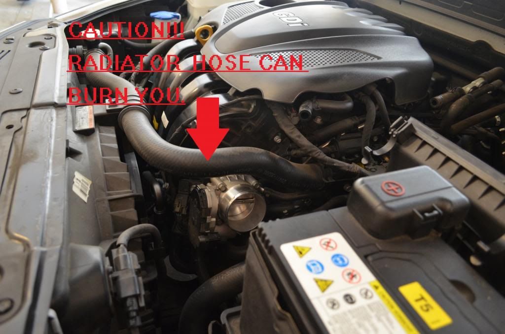

    CAUTION CAUTION CAUTION CAUTION CAUTION CAUTION
    Perform this job when your car is completely cool to touch
    The Fat Hose around the throttle body is very hot and it can burn you.

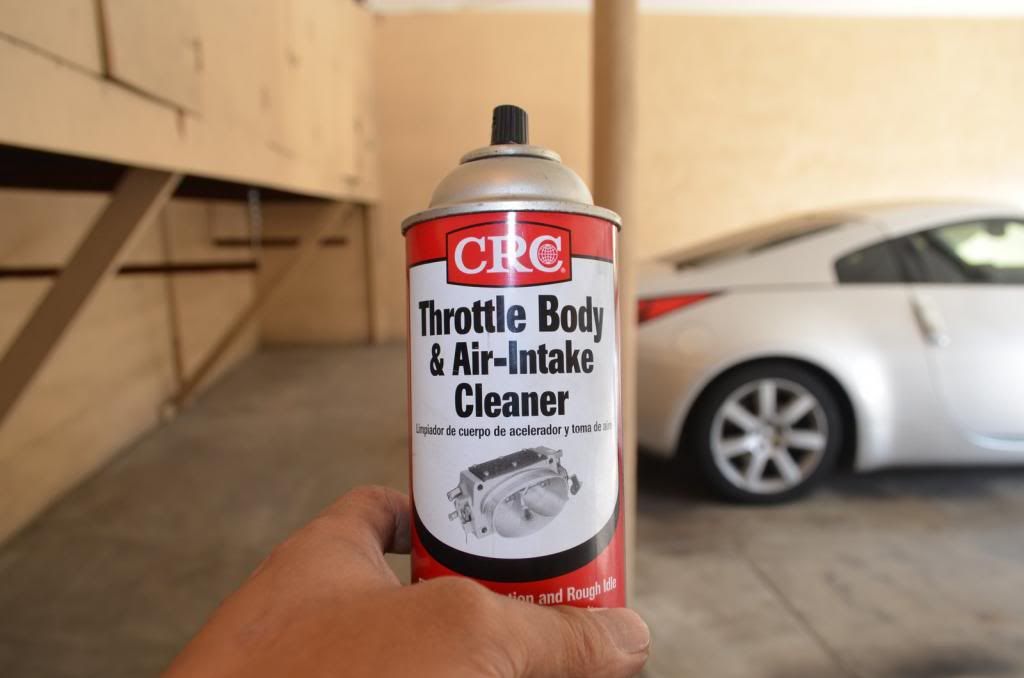

    • Throttle body cleaner ( I used CRC branded one $7 at Pepboys, I cleaned 5-6 cars with one can.)

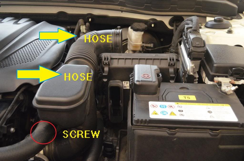

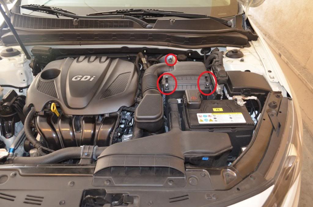

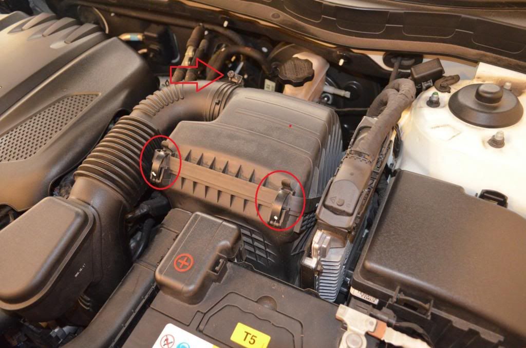

    Step 1. Remove Air filter Cover
    a.Unclip 4 clips which connects the top and bottom part of the air filter cover.
    there are two on front and two more on back.
    b. Unscrew and loosen the hose holding metal ring. The screw does not completely removed, just to a point the ring goes around freely around the rubber hose
    c. detach top air filter cover from the Big hose.

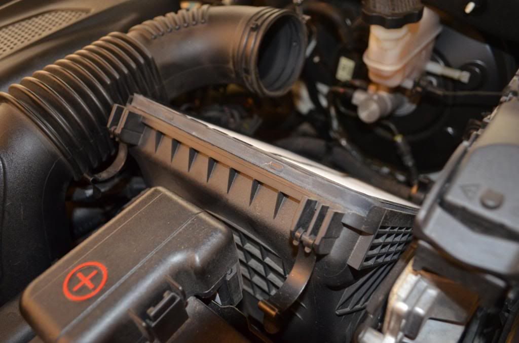

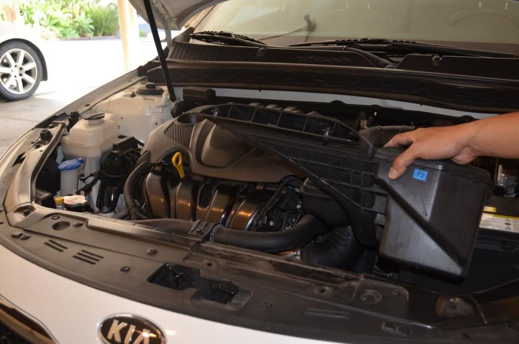

    Step 2. Remove front air intake
    It’s only held by two plastic clips on the front. I used the small flat head screw to wedge it between Screw looking like piece and the plastic bottom Part.

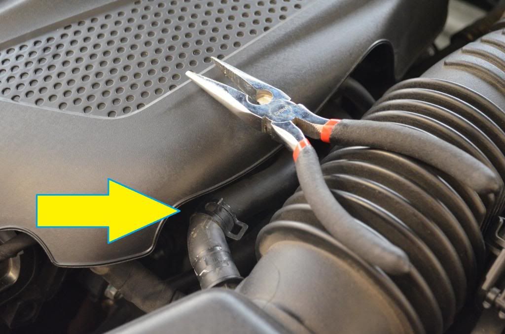

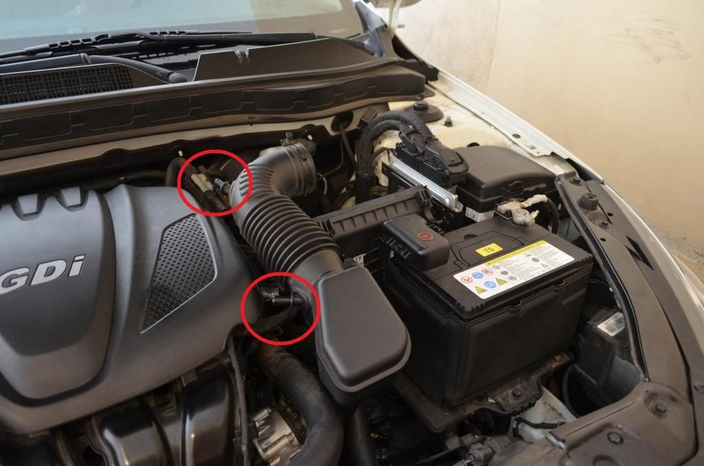

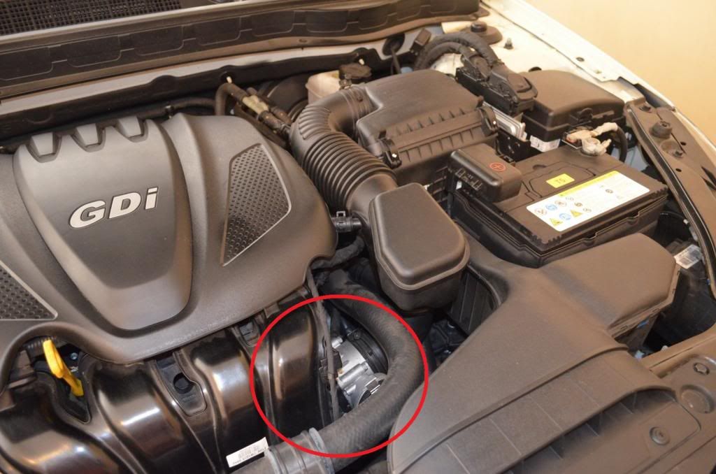

    STEP 3 REMOVE the air hose from the throttle body.
    Remove 2 smaller hoses from the main big pipe.
    1. Use pliers to move the metal clips towards the middle part of the smaller hose.
    2. Gently wiggle 2 small hoses off of main hose.

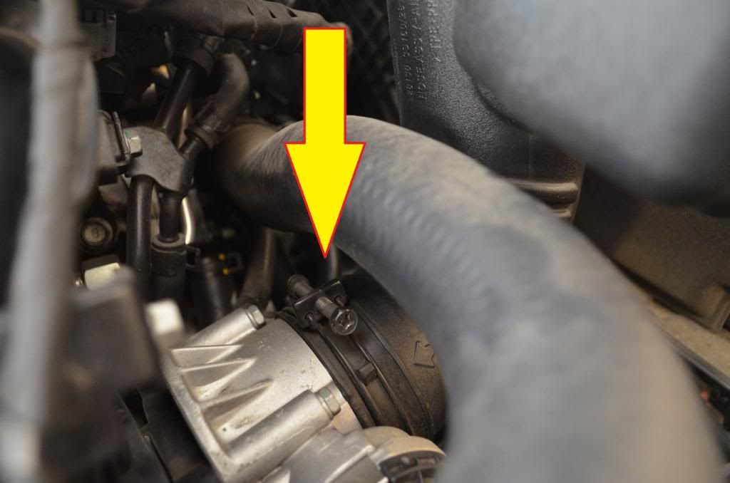

    Untight the screw which holds the air intake hose from the throttle body.
    Wiggle to get the hose detach from the thottle body.

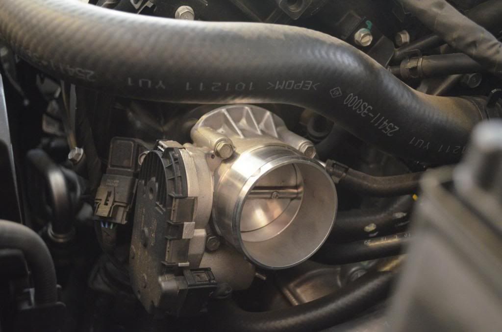

    Step 4. Clean
    (sorry no pictures... hard to get the shot when i was working by my self)
    Using the throttle body cleaner and toothbrush and towel, clean the carbon build up on the round plate and the pipe.
    you would need to hold the plate open. I just used my fingers.
    If you drop screw driver in the hole... you will be very very sorry.
    DO NOT USE excessive force. and damage the throttle body.
    Most of carbon residue will be cleaned by chemical it self.
